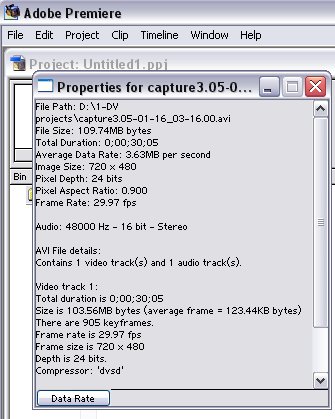

    I've used winDV and it inputs standard DV 720x480 for me. Here is the data from a WinDV import.
