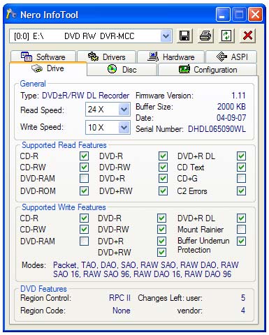

    That didn't work ... it didn't give model/make info. It gives the firmware as a number only so no joy in determining the model/make.

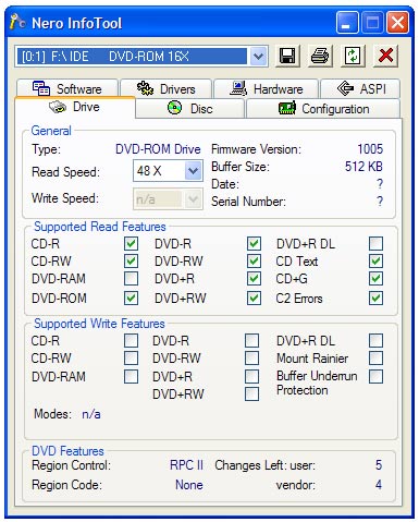

    Here is what NERO INFO TOOL says:
    For the DVD Burner:
    For the DVD-ROM:

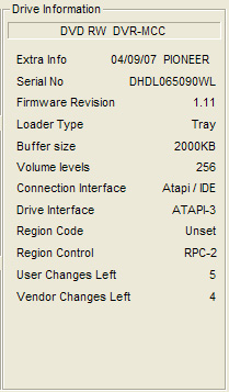

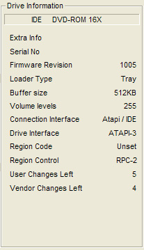

    But I did download it just now and it says:
    DVDInfoPro on the DVD Burner:
    DVDInfoPro on the DVD-ROM drive:

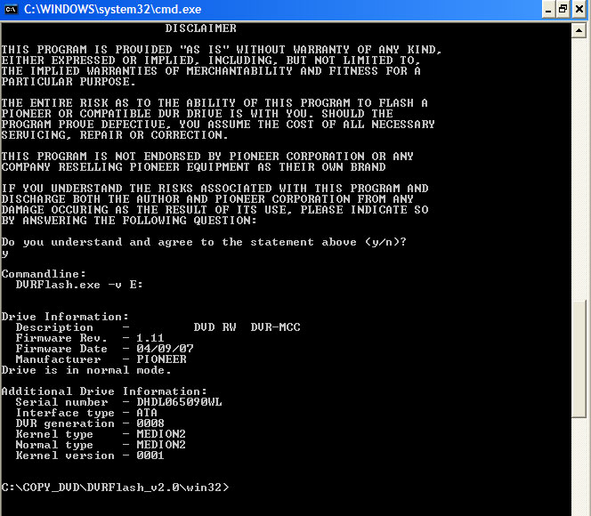

  12. The specs of the DVR-MCC and the DVR-108 have almost nothing in common so I would not be so sure that they are the same.
    Can you download DVR-flash (first link under firmware tools) and run it with "dvrflash -v X:" (X is the drive letter). What does it say about "DVR generation"? Or even better if you can open the burner at take some photos of the inside including chipsets.

    OK I ran "DVDRFlash.exe -v E:" and this is what I got:
    What does this tell me hehehe

  14. Well generation 8 is the same as the generation of the DVR-108 but I'm not sure how DVRflash check this (ie. if it can be trusted or if it just checks it in a "stupid" way) and I guess there still can be some differences that makes it impossible to flash it with a DVR-108 firmware.
    Anyway there have been some discussions about this drive over at rpc1.org where you also find most of the Pioneer firmware experts so you might want to check there for more info.
