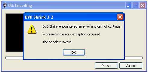

    I 1st decrypted to my hard drive with DVD Decrypter with no probs or errors. I then try to use DVD Shrink 3.2.0.15 to shrink it down to fit on DVD-R & I get this message:
    Any Ideas? I have ripped several DVD's before this & I have installed nothing new.

    Hello,
    Rerip in iso read mode in dvd decrypter. Then open the iso in dvdshrink. If you still get the same error message use another transcoder
    Kevin

    Another transcoder such as what?
    And when I try to rip it & compress with DVD Shrink I get this error as well.

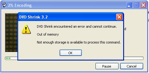

    Tried this method & get a new error with DVD Shrink:

    Ok the memory error has stopped but I am back to the old error again, I have never had this problem with DVD Shrink. Whats up?

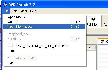

    Pls enlighten me how to open an iso file with DVD shrink if the file is over 4GB in FAT32 XP?

    IN Shrink 3.17 or later choose File then choose Open Image file
