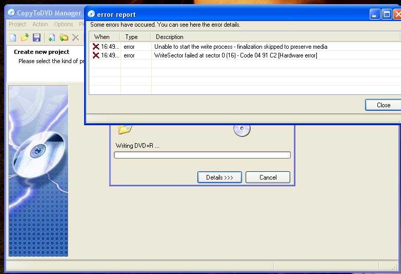

  1. Hi, I got my new tayuo yuden dvd+r discs today..
    But when I tried to burd a dvd movie I got this error message!
    "picture"
    anybody help me? Sucks to buy wrong DVD+r's AGAIN!

    Image never came up. Can you check the link? Thanks

  10. hmm, something strange happend.. I got the working.. I burned a dvd and play it at my standalon.. and it worked.. So I tried a to burn a new one, same error!
    I am going to try updating copy to dvd!
    CrAp!
  11. nope, that did not work, Got the same error!
    CrAp!
