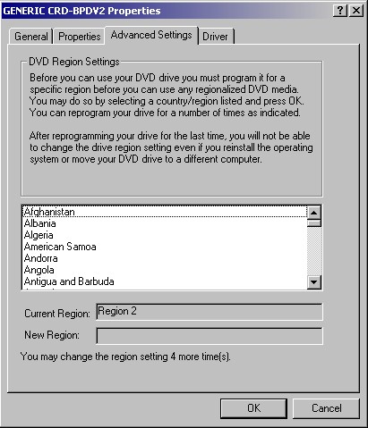

    Region coding is encoded on the disc. The burner will pass whatever region coding information is present to the burned disc, unless you change or remove it with the software. Now your DVD drives are hard-coded for a specific region.
    Your DVD Burner will come with a region already preset. But just because you purchased it in the United States doesn't mean it will automatically be set for Region 1. My Optorite DD-0203 drives were set for Region 2 right out of the box.
    You are usually allowed 4 region changes on a DVD drive before you are locked out. Unless, of course, you apply a region hack. I don't, since I never need to worry about region codes myself.
    As you can see, here is one of my Optorite drives...

    I applied the hack for the Toshiba that removes the ripping limit on the drive, which is why it only shows one region change left.
