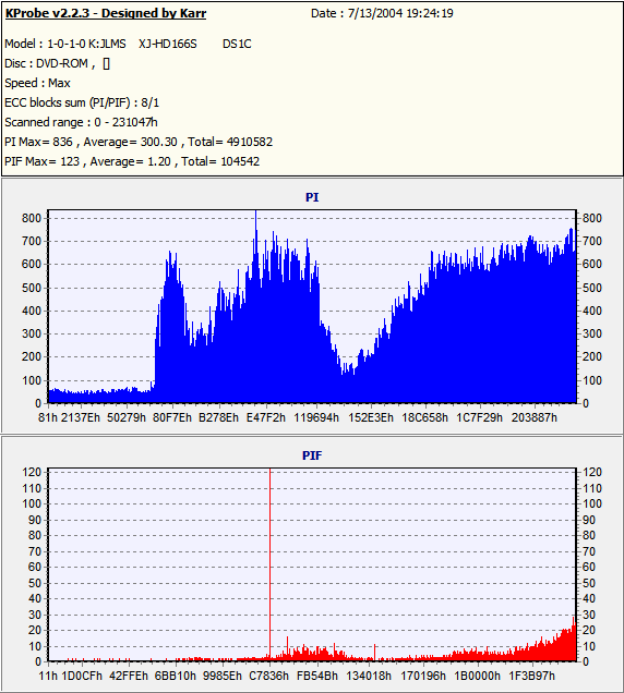

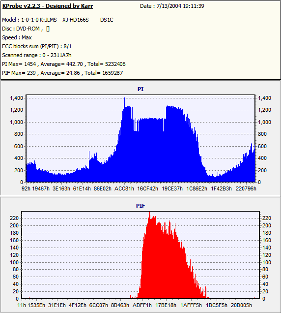

    Here is a scan done at the recommended Kprobe settings of a Verbatim DLP 8x -R disc, burned on an ND-2500A.
  7. Can you interupt your findings ... WAS that good or BAD?
    Join Date: May 2004
    Location: United States
    That is a horrible scan, but I'm guessing it's due to the fact that DVD-ROMs just aren't that great for KProbe scans. I'm running a scan of a 4x Verbatim DLP burned at 8x at the moment, and so far it seems to be a better burn...?!?! Madness.

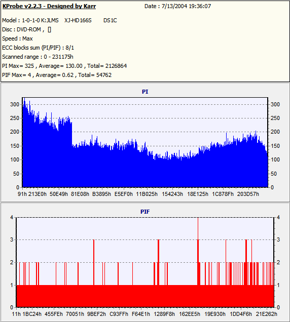

    MCC01 RG20 burned at 8x. This isn't much better:

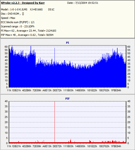

    I noticed the two Japanese DVD burner sites I frequent use Lite-On DVD-ROMs to do their KProbe scans, but they set both PI and P0 to 1. I decided to give it another try, using their settings.
    TYG02 scan:

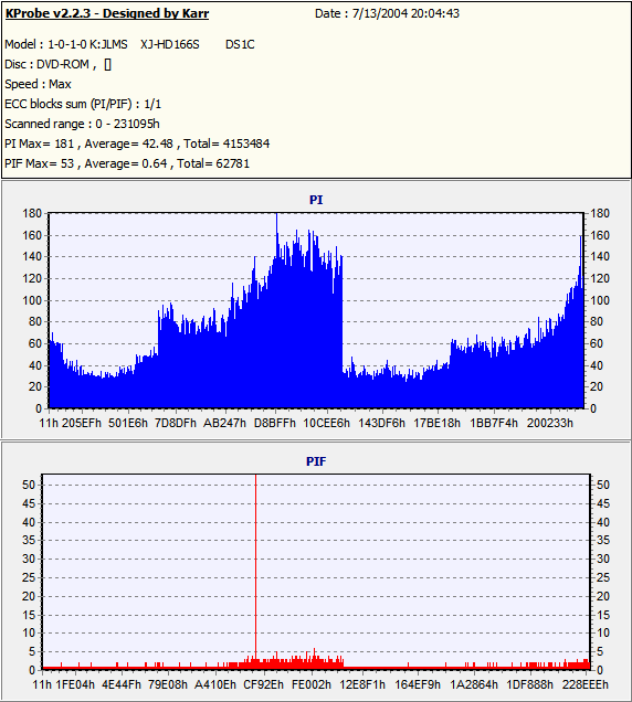

    And finally, the Verbatim 8x DVD-R scanned again using the settings from the Japanese sites:

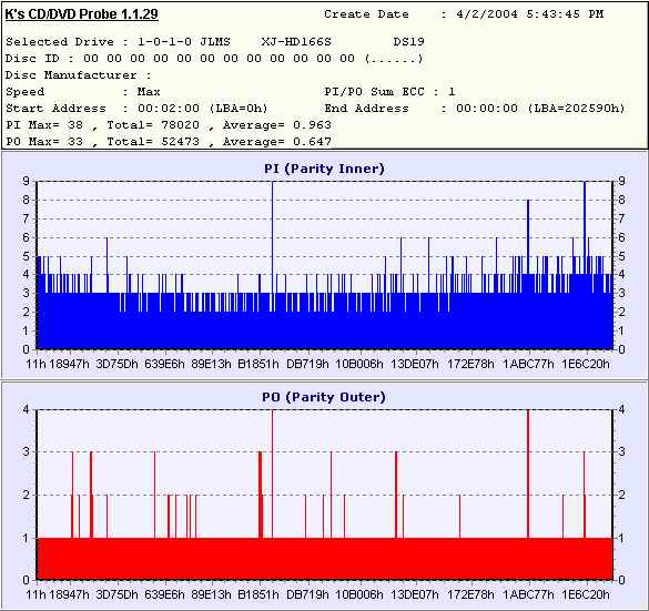

    That is a marked difference. Compare my scans to these: http://homepage2.nifty.com/yss/nd2510a/kprobe_8x.htm
    Perhaps those Japanese sites are onto something...?

    The picture of the spindle is Taiyo Yuden 8x DVD-R media (TYG02), burned at 8x, with the Plextools and KProbe scans below (the format of the page is a picture of the media, followed by the error scans of it). Below that is a Taiyo Yuden 8x DVD+R scan, followed by a Ricoh 8x +R scan, then a Mitsubishi 8x -R scan. Focus on the Taiyo Yuden and Mitsubishi -R scans as those are the same media I tested.

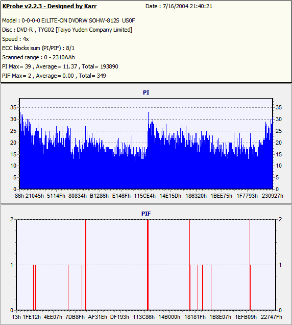

    Man, what a difference a drive can make. This is a scan of the exact same TYG02 disc that looked so horrible before:
    That 166S was jacked. Anyhow, getting back to the original topic, I walked into a local Best Buy today and they had Verbatim DVD+R 50 disc spindles on sale for $39.95. There were only two spindles there, but one of them was the mysterious retail 8x spindle. I started to buy, but seeing that they were made in Taiwan, coupled with the fact that I already have more discs than I know what to do with, reason prevailed and I put them back on the shelf...okay I did it at the last minute before I was about to buy them, but I put them back nonetheless!
