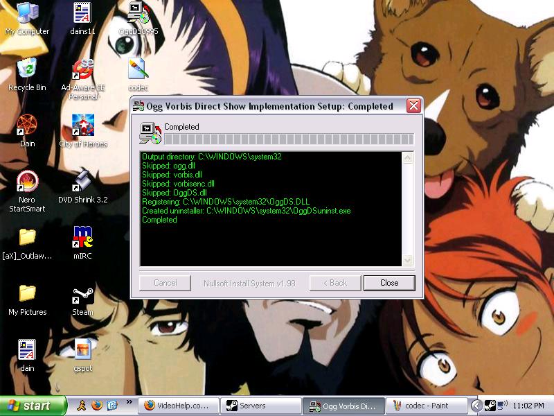

  2. but dafreak, the weird thing is, Ive dl'ed that before. I tried to dl it again from the link you gave me, and it installed in under a second. When I went to details, it seems to have skipped things. Here is the pic:
    p.s.
    Hope you like my sweet desktop =P
  3. hmm, well from your first pic, gspot said that you didn't have ogg vorbis installed. try running the ogm file in tmpgenc again and see what happens.

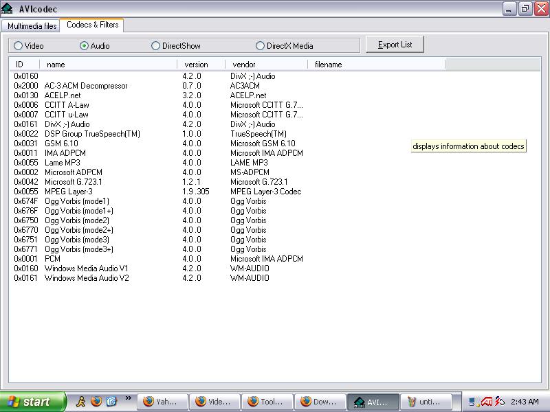

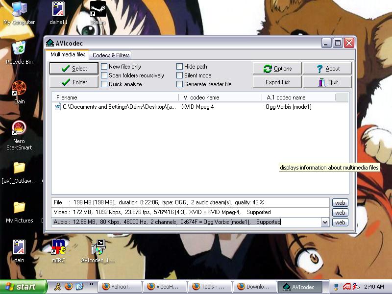

    try this. dl and install avi codec and run the ogm file through there. let's see what type of acm is required.
    also,
    I think this has something to windows. you might try dling updating new windows media player. it might have the proper windows audio compression manager.
  19. I installed the new wmp, and it didnt work =( But heres the pics for the program u told me to dl
