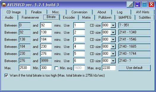

  2. Stuff the .avi through GSpot, and you'll find it's probably about 2.6hours...maybe longer.
    In dvd2svcd, look on the bitrate tab.
    Set the min and max to bracket the movie's length, then split into two 80 min cdr's.
    For a movie of that length, to get decent quality, I would run a 2 pass vbr, and split it onto 3 cdr's.
    Here's my bitrate settings for dvd2svcd.
    Cheers, Jim
    My DVDLab Guides

  4. It's not complicated.
    The "Between", is how many minutes minimum, and "and" is minutes max.
    So if a movie is between 138 and 184 minutes (see my picture), it will be split to go on 3 80 minute CDR's, at a bitrate between 1546 and 2141.
    If it's between 92 and 138 minutes, it will go on two CDR's.
    If you arbitrarily set the bitrates to the settings you want, you could end up with 3 cdrs, but the 3rd may only have 3 minutes of movie on it, or you could end up with 2 cdr's, but the second only half used.
    Unless you're good with the bitrate calculator and gspot...then in dvd2svcd, set the minute span around your movie length, force it to 2 cdr's, and it will set the bitrate approx what you want.
    IMHO that is way too low for a high-action movie of decent quality, and I still recommend doing it on 3 cdr's.
    Cheers, Jim
