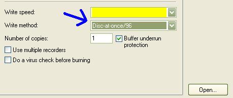

    On the screen that lets you select the Burn Speed and whether to finalize the disc there should be a pull down with options Track-at-One , Disc-at-once and Disc-at-once/96

  7. No. In the earlier versions of 5.5x you could select as follows:
    ..for DVD as well as CD. If it is greyed out, you have a later version
    BUT you still need to upgrade - it is free up to the last version of Nero 5.
