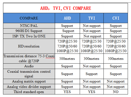

    If connectors are compatible then there's not much more to do except provide power and hard drive for cctv system if it needs one.
    From there it's setup system date and time, format drive, check camera's are functional and adjusted accordingly.
    Most likely the system is bnc and cameras rca ... you can get conversion connectors cheap in ebay to do the job.
    Shouldn't take you long to fix the problem.
  3. Bjs,
    thanks for input,
    the cables do have bnc connectors, and the cams do too.
    I have M.Sc computer science, but I am way out of my depth with this stuff.
    different media and protocols etc, I did not understand most of the tech terms in the comparison table
