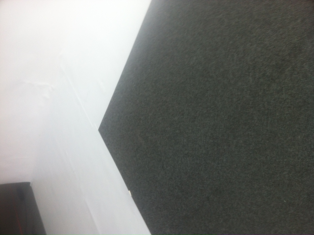

  5. Hey guys,
    So I managed to sort things out regarding the lighting and everything is looking improved. I'm still having the issues with the seams on the styrene flooring. I've attached a picture.
    Due to the circumstances I can't rip up the carpet in the studio. Can anyone suggest another solution for a all white floor? Even if it was possible to make the seams less noticeable.
    Cheers,
